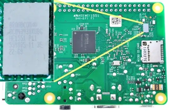

The network module is a a BCM43438. I'm having trouble finding a source I fully trust, but from a cursory view, it looks like it only supports 2.4 GHz. Since the Raspberry Pi foundation doesn't specify, it'd be normal to assume a lack of 5 GHz.

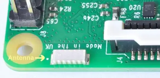

An image on raspi.tv displays a very compact antenna. Reception with the default antenna may not be stellar, but we won't really know until it starts getting into reviewers' hands.
Image of the wireless module
Image of the antenna
Edit:
As @EDP has pointed out, there appears to be only one Wi-Fi antenna. This further implies that there is only support for 2.4 GHz.
