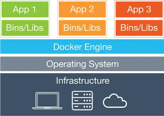

While not full virtualization, have you considered Dockker on pi?
https://www.docker.com/what-docker
Docker allows you to host containers, which are lightweight and offer a lot of flexibility. They have advantages (and disadvantages) when compared to full virtualization but depending on what you want to do they can be very flexible.
I've not tried docker on Pi, but do have it on my laptop and if you are somebody who likes to try new things and tinker then it's great.
