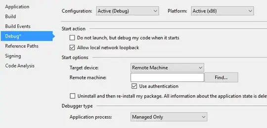

They solved the issue by setting the authentification mode to "Universal", but I don't have this option, in fact when I initially selected the device, I only had Windows or None. And if I got to the settings now, I've only a checkbox: enter image description here
I'm not sure what I did wrong, what I don't have this option, any idea?

  1. I can see that the project screenshot has x86, project platform must be set as ARM

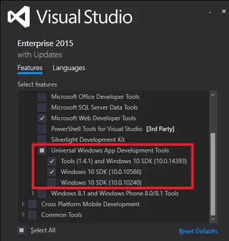

  2. Install VS2015 update 3 with see attached image
visual studio screen shot
