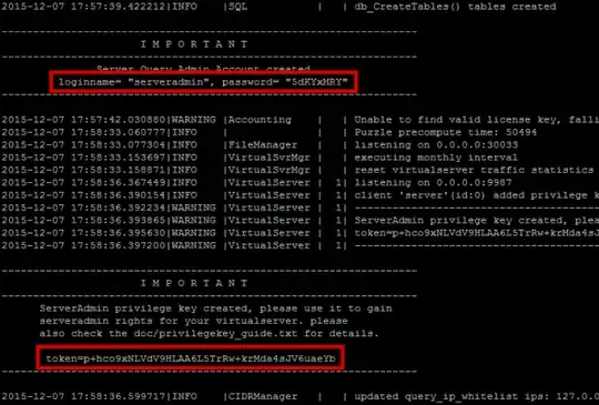

  6. Start ts3 server
     /usr/local/teamspeak/teamspeak3-server_linux-x86/ts3server_minimal_runscript.sh
    enter image description here Your ts3 server is running. You should copy credentials which will be required for connecting with teamspeak 3 client.
