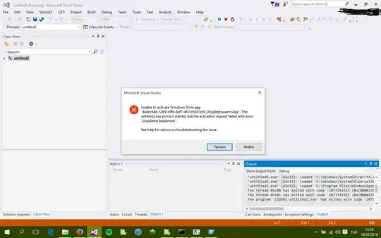

Everything was good from there. I opened project with Visual Studio, clicked Remote Machine, after one or two seconds I got this error:
I can see Qt Logo in Raspberry Pi monitor but always one or second later get this error.
I searched and I found this solution, some application doesn't work 10.0.10540, maybe try 10.0.10240 and formatted and installed that version but result is the same I get same error.
