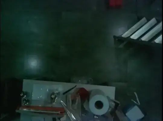

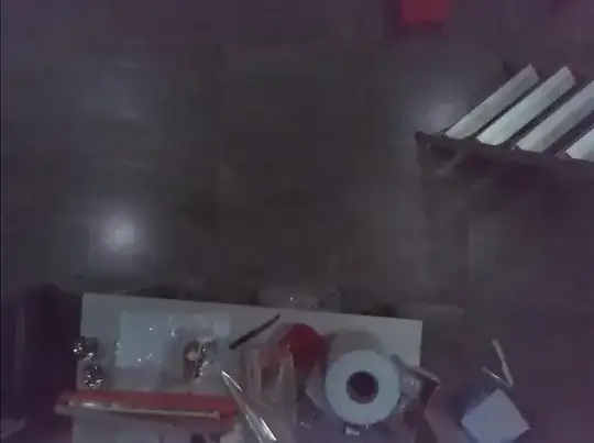

Here are sample of initial setup frame and post purple haze addition, Trust me the haze is more than the one shown in the image.
The desired output
Post purple haze addition
Check your white balance (awb_mode) and exposure times (shutter_speed). Those pictures look like they were taken on a factory floor with Mercury Vapor lights in the rafters. Those lights are terrible for photography. In that case, your best bet is a Fluorescent white balance setting and a longer exposure setting. You could also try adding some task lights over the work area.
