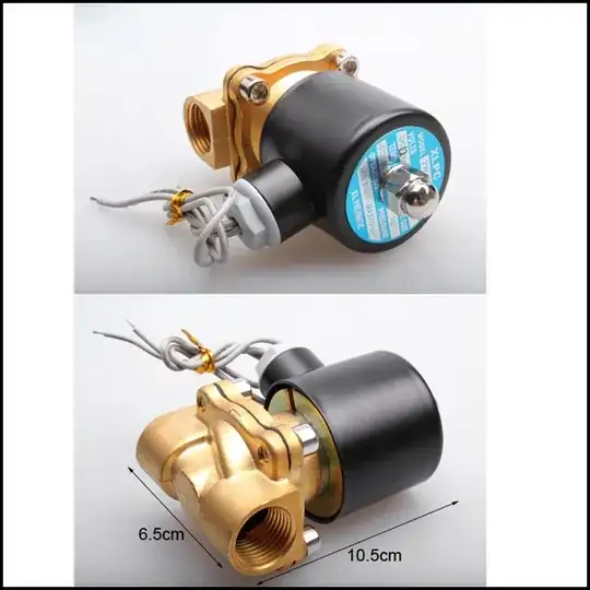

You can use a gas solenoid or valve to control the CO2 supply.I am not sure if it is linear, as in control the flow amount or just on or off. But in order to provide linear power you would need something clever to drive up to 12volts. Otherwise a simple relay will work.
On ebay here
