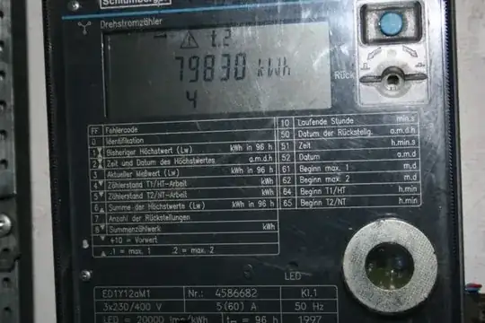

The wild idea is to put a camera in front of an energy meter or watt meter display and read the accumulated total in the display, and process it down to digital information like an integer or a float that i can save. It might be enough to capture a still, crop the image and do some ocr-like operation.
Energy meter example
The advantage over monitoring pulses is that You would keep track of the actual meter total, not a forever running incremental.

I recently used Tesseract which is an OCR software that's open source and it gives highly accurate results.
To install it on pi, type in the command line:
sudo apt-get install tesseract-ocr
Then set a camera to periodically take pictures preferably using Cron (which schedules tasks) and fswebcam (takes pictures using USB cams) Save the pictures in a special directory and set (also using Cron) Tesseract to extract the text from the pic and output the text in a separate .txt file. Deal with the extracted text according to your preferences.

Assuming you are able to store the image somewhere, that you can setup Python's PIL dependencies, and have pytesseract you'll need : https://github.com/madmaze/pytesseract
open and crop the image so that only interesting data remains : http://matthiaseisen.com/pp/patterns/p0202/
then try something like :
import pytesseract
import Image
img = Image.open(path_to_your_file)
cropped = img.crop( ... )
pytesseract.image_to_string(cropped, config='outputbase digits')

I understand that link-only answers are really not the way of StackExchange, but this page is too good a fit to this question to not point to it. This tutorial completely covers all aspects of relevance to capture the image and use OpenCV on a Pi process the image to read the value of the electricity meter.
Side note: if you do not want to use a Pi on this, try an ESP32.
