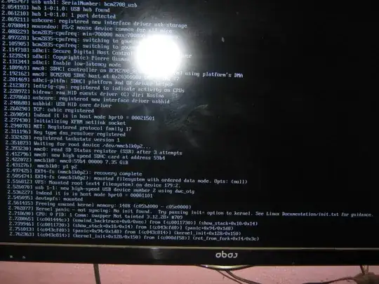

After executing this script All things are changed I am not able to use any other command then cd and I think to restart Raspberry Pi but it ends up in the state as shown in image Error While boot process is started
I don't know how to
  1. Access the terminal now.
  2. If terminal is accessible how to execute all command when i am Root
