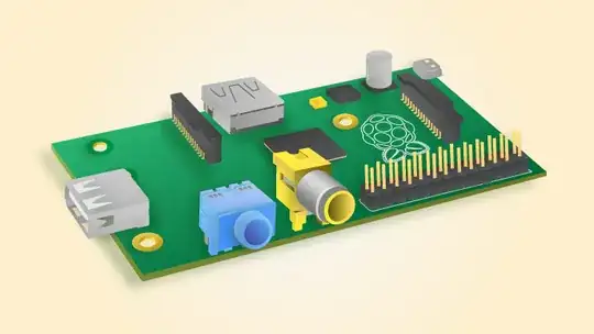

Model A: enter image description here

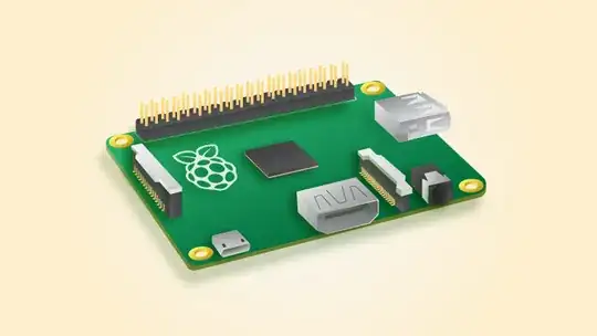

Model A+: enter image description here
