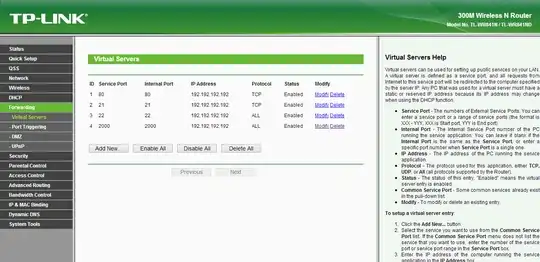

I have an Apache server running on my Raspberry Pi. The Pi is behind a router, having local IP address 192.192.192.192. I use the Virtual Server feature of the router to allow traffic through ports 80, 21, 22 and 2000. My website connects to the Apache server through port 80. I use afraid.org for Dynamic DNS.

  • My router is blocking the incoming ports. I don't actually know how to configure the virtual server to redirect incoming mail to port 2000 rather than port 80.

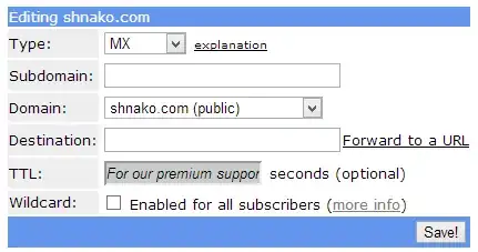

  • My MX settings are not good. I'm pretty sure about this, but again, I have no idea what I should set the fields to.

  1. Be sure your MXsettings are in place.
  2. Open port25 ingoing to your raspberry.

  1. Smtpmail works on port 25, which you have to forward ingoing, it is clientsoftware that goes on ie. 2000.
  2. Your mxsettings has to point to your external Ip or valid ddnsname.
