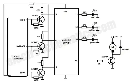

I have built such a circuit in the past for some friend that had a small production plant and needed to keep track of water levels in a tank.
I don't have the drawings anymore, but the circuit was something like this one below (from http://www.electroschematics.com/9964/arduino-water-level-indicator-controller/). It's for an arduino and should work just fine on the Pi. enter image description here
I would place the transistor close to the measuring point to avoid interference from power cables in the house. If you only need 1 measuring point then use a pair of cables to wire it directly to the GPIO and read a high/low condition. Keep the tips of the cables in the air some 5mm (1/4") apart at the measuring height you want to detect, don't let them touch anything else.
