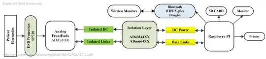

No RP is a medical device. RP must be isolated from the ECG front-end (etc power and SPI commiserations) which is done by ADums in Biosignal Pi design (Farhad).
Isolation Strategies of ECG front-end from RP
  1. Assume Pi B+ could behave like any other component. (used in the publication)
  2. Switching to Pi 2 B should not alter the situation but the maximum power of the circuit unknown and dependent probably on ADAS1000.
  3. When proving the Pi is sufficiently isolated by the ADAS1000, the assumption that Pi behave like any other component must hold.
  4. If the RPi suddenly decides to act as a 0 Ohm resistor between the power supply and the patient, ADAS1000BSTZ should ensure the isolation. (1-3) but the upper limit of the power is TODO in the circuit.
  5. If RPi catches fire, isolation of the system, Creepage air clearance and SP720.
  6. 0.5W extra power draw is safe so RPi zero and A+ accepted. How sufficient is 0.75W power? Limitations of RPi B+ in the power sense?
  7. ADuM4400 safely withstands 5000 Volt for 60 seconds. The power supply isn't shown, but it is reasonable to work on the assumption that it's a cheap 220V transformer. No risk when 380 V peak (<< 5000) which is well within safety margins. (Joan)
  8. Keep RPi in noninflammable enclosure to prevent burns. TODO I sent email about Raspberry Pi Case to the producers. (Joan)
  9. [conjuncture for Double verification of the isolation]. Viscoelastic material characteristic can be used to estimate continuously without altering the system in the runtime if the system's resistance changes by some FFT of the system. If zero resistance, the schema probably changes from the Kelvin-Voigt model to the Maxwell model. (here) This mechanism can be connected to the system as a negative feedback such that it automatically switches off the power if the event occurs. I think the first level mechanism of ADAS1000 can be problematic with high powers because the components can break in such cases.
Schema in the publication
where the change is an addition of a GUI for real-time visualization by FFT and multi-threading. This addition ensures the isolation of the ECG front-end from the RP because of ADums in the Biosignal Pi design.
