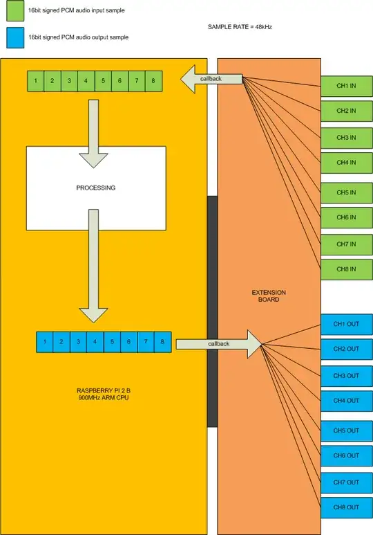

I am about to start working on a project which involves real-time audio processing for an audio effects application. The application is supposed to acquire and process audio from 8 individual audio input channels at a sample rate of 48kHz. The audio processing algorithm generates audio for 8 individual audio output channels. The audio sample format is 16-bit signed LPCM. Since it's for a real-time audio effects application, latency is also important. If audio is looped from input to output without any processing, the round-trip latency should not exceed 12ms.
The application should receive 256*8 input samples every 5.33ms (via an audio callback), process those samples and transmit 256*8 output samples (also via callback). The 256*8 samples are received/sent in some kind of "interleaved" format.

Block diagram

The short answer is yes, no and depends, the long answer is probably no, but might be yes depending on your approach. As a piece of hardware, the Pi is quite fast, and can probably handle the shifting of data from input to output reasonably quickly. However, the default setup, of raspian linux, is not a realtime platform. What's more, you've not specified what DSP you want to do. Back when I was at university, in the days of 386s and Windows 3.1, if you wanted to do serious sound processing you needed an external DSP chip to be able to make it all work.
If this were to work on the Pi, you've got a few options. First option, probably the best way to do it, would be in hardware, using interrupts, and a separate DSP module. I'm not sure what's out there, but it's worth considering that mostly the Pi interfaces with USB and that has bandwidth limitations, so you might be out of luck anyway. Secondly try coding it as a kernel module and see what kind of throughput/processing power you can get out of the Pi, User mode linux is not realtime, and while it'll be a useful proof of concept (doing it in usermode with a high process priority) you may need to go into the kernel to squeeze more speed out of it. Finally the linux kernel, even in it's cut down pi version, does a lot of stuff, you don't need for a simple DSP device. I think I saw a kernel out there somewhere that would turn your PC into a network router. Something that basic is all you need, but you'll have to get down and dirty with some C kernel hacking.
If you want to do the sums and try to work it all out, you need to write the assembler for whatever your processor is going to do with the data, and work out how many process instructions will be needed to load the data, change it and write it out, and see if that multiplied by the 48k*2 is going to exceed 900M, and if not, by what margin (everything else the device does, has to function in that margin, hence my suggesting you minimise that by losing the normal kernel stuff). I think it highly likely that it'll not work, but it really depends on what processing you want to do. You might be able to compile your own kernel with nothing in it, except your own kernel module, and have just enough space. You'll have to try it and see.
