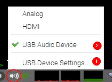

In the desktop GUI you have then to select USB Audio Device and Verify USB Device Settings. Activate there all options (Mic, Speaker, etc)
