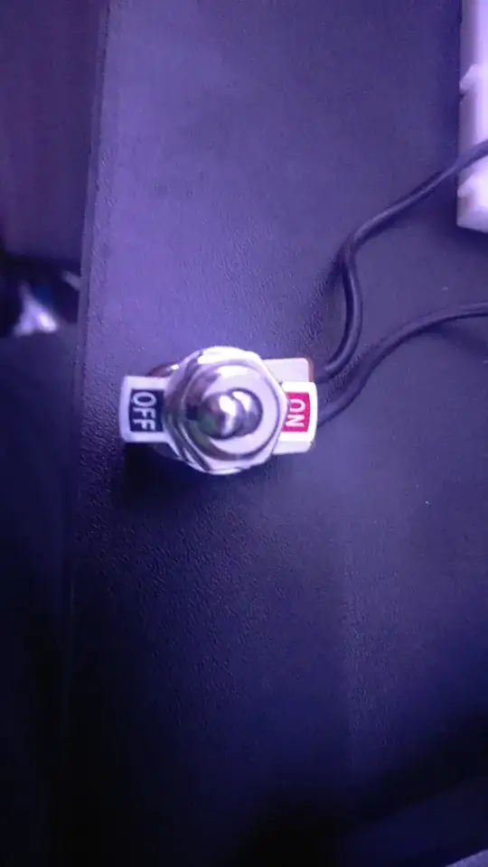

I want to add a on/off switch to my pi 2 to correctly shut the pi down
This is the switch I want to add:
Edit: moved from a link to be included below: A Single Pole Snap action chrome-like switch with a plate bearing the words "On" (on a Red background) and "Off" (on a black background) with wires going off out of the picture

but he didn't explain how to wire it up. Also I have no idea how to add the code to the pi.
I'm running kali. I haven't tried to wire the switch or put the code in the pi because I do not know how to.

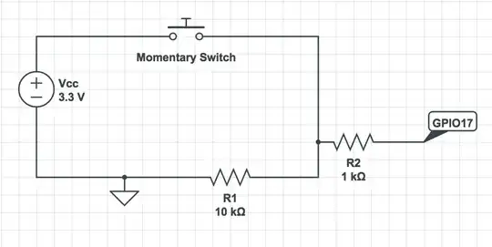

I just finished building a power-off circuit yesterday, although mine uses a momentary switch.
Here is the python code (with attribution embedded):

The really important thing to remember is that you should have two resistors in your circuit, like so: circuit schematic
R1 (a 10k resistor) goes to ground and keeps your chosen GPIO pin from floating, while R2 (a 1k resistor) helps prevent damage to that same pin from the 3.3V source.

So you will need to wire a switch between the GPIO pin that is 26 (physical pin 37 IIRC) and rather than rely on an internal pull-up I'd also connect a 10K Ohm resistor between that GPIO pin and 3.3V. Then you need to get that code to be run as a user with permission to use the GPIO pins - for this the root user is a reasonable choice because you do not want a normal user to interfer with it, and you want it to start when the Pi is booted up and to be running until (it tells the Pi to) shutdown. The easiest way to do that is to paste the entire code into a (text) file and save it as something like gpio_poweroff.py, it will be helpful to mark it as executable with chmod u+x gpio_poweroff.py and place it in /sbin with sudo mv gpio_poweroff.py /sbin. Finally you need it to be run when the Pi is started up, and that varies on something that I do not know about your system. If it was my system I would insert the command to run it: /sbin/gpio_poweroff.py & into the file /etc/rc.local {the & is important, it means let it run in the background, don't wait around (for until that button gets pressed otherwise) for it to finish}. However I am not certain that your system will have such a file - if it does then it should be Ok to use it.
