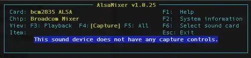

I don't believe the Raspberry Pi has the necessary hardware to capture audio input. You can confirm this running alsamixer.
That would explain why alsaaudio.ALSAAudioError exception was thrown by alsaaudio.PCM.__init__ method.

I hit this error with code which works perfectly with my USB mic on Ubuntu but refused to work on RaspberryPi.
First, since the question was asked, card is outdated and replaced with device.
Second, I had to run alsaaudio.pcms(alsaaudio.PCM_CAPTURE) and use EXACT FULL line of that output as device. In my case it was full line "hw:CARD=SHG7980,DEV=0". Just 'SHG7980`, '0' or whatsoever else didn't work.
