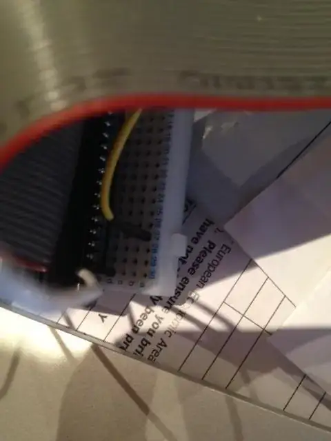

This shows the white wire going to the 3v3 pin and the yellow wire going to gpio4

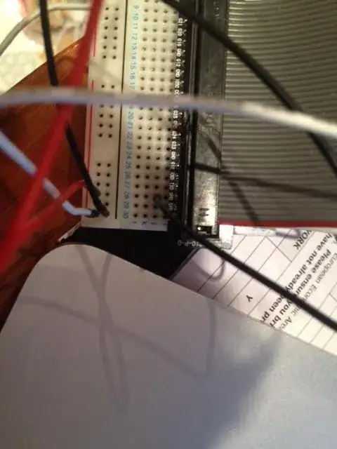

This shows the black wire going from ground to the ground rail on the breadboard, the other end of the white wire going to the positive rail on the bread board and the red wire taking the power to Pin Three on the sensor

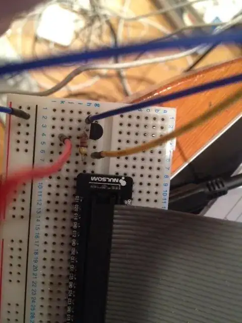

This shows the wiring for the sensor. The red wire carries power to Pin three, the blue wire grounds the sensor and there is a 4.7kohm resistor going from Pin Two to the yellow wire that finishes at GPIO4
The first picture shows the white wire going to the 3v3 pin and the yellow wire going to gpio4
The second picture shows the black wire going from ground to the ground rail on the breadboard, the other end of the white wire going to the positive rail on the bread board and the red wire taking the power to Pin Three on the sensor.
The third picture shows the wiring for the sensor. The red wire carries power to Pin three, the blue wire grounds the sensor and there is a 4.7kohm resistor going from Pin Two to the yellow wire that finishes at GPIO4.

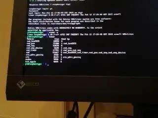

uname -a: Linux raspberry 3.18.7-v7+ #755 SMP PREEMPT Thu Feb 12 17:20:48 GMT 2015 armv71 GNU/Linux
