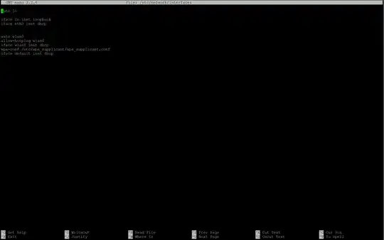

sudo nano /etc/network/interfaces
Make sure your screen looks like this, if not type it in.
When you're done doing that, press Control+X, type y, and press enter.
