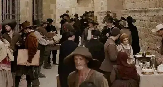

QuickTime X still of 720p video transcoded using HandBrake (x264) on a MacBook Pro (open or download image for the full detail):

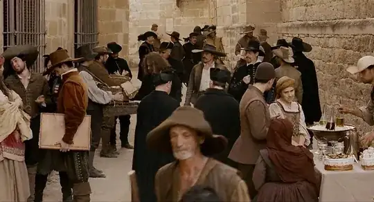

QuickTime X still of 720p video transcoded using GStreamer (hardware encoding through OpenMAX) on a Raspberry Pi 2 (open or download image for the full detail):

Following ecc29's suggestion of using lanczos scaling method I performed a test adding method=lanczos to videoscale. The encoding process doubled in time, jumping from about 7min to 14min 37s. The result is almost equal in quality to that without method (default bilinear). Indeed, the defects mainly come from the encoding process in hardware. They are clearly compression artifacts.
