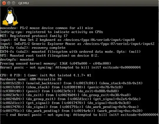

I followed the various tutorials on how to run it under qemu (I use ubuntu) and use this command:
$ qemu-system-arm -cpu arm1176 -m 256 -M versatilepb -no-reboot -serial stdio -append "root=/dev/sda2 panic=1 rootfstype=ext4 rw" -hda Kanux-Beta-v2.2.0-jessie-release.img -kernel kernel-qemu-4.1.7-jessie
The Kanux-Beta-v2.2.0-jessie-release.img is downloaded from the Kano Website (Download the image directly link), the kernel-qemu-4.1.7-jessie from the other "raspbian on qemu" tutorial.
But I always end up with a kernel panic right after booting:
After searching the web, I suppose the error is maybe because kernel and img do not fit each other. If so, where get the right kernel from?
And anyway, has anybody run Kano OS in an emulator? Is it possible?

Yes and no. It is not possible to run the official kano IMG in Qemu but you can run Raspbian and add the kano repositories to the sources.list file.
Install Raspbian Jessie on Qemu (This is for windows, just remove the .exe and stuff): Do this
Add this to /etc/apt/sources.list.d/kano.list:
deb http://repo.kano.me/archive-jessie/ release main
deb http://repo.kano.me/archive-jessie/ release-urgent main
Run this to get the gpg:
wget -qO - http://repo.kano.me/archive-jessie/repo.gpg.key | sudo apt-key add -
Then run:
sudo apt update
sudo apt install kano-os #Which will install everything preinstalled on kano
You won't get the 'white rabbit' setup or anything, but on the next reboot, you will very likely get a kano desktop!
