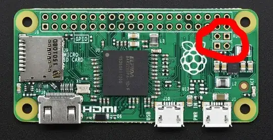

I'm still waiting to sort getting a Pi Zero, but a thought has just occured to me.
The Pi Zero has 4 pins which are AFAIK something to do with video:
So I have two questions:
  • What is the pinout for this?
  • Does it include an audio output?
The reason I am guessing this functions the same way as the RCA jack on the B+/2B, which I think includes stereo audio and a composite video connection (2 pins for audio, 1 pin for video, and 1 ground). In which case if I was to get a Zero, could I use this as a audio (and video) output via connection to a RCA or similar cable?

No, those pins have nothing to do with audio.
The upper two pins are to reset the Pi and are labeled "Run". While we have no schematics of the Pi Zero available yet, we can deduce this from former models of the Pi. According to this article it's a two pin header. The circuit with two clamp diodes, a pull-up resistor, and capacitor connected (at least that's what we know about the model B, Rev 2.1).
The lower two pins are dedicated to composite video out.
Note that in both cases the circular pads are ground and the rectangular pads are the respective signals - reset, and composite video out.

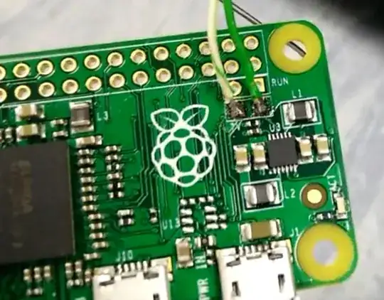

Just like @Ghanima said, the top two, labeled "RUN" are the reset pins, if you wire them together it will hard reset your Pi.
Now, as for the bottom two pins, the square one is TX (signal) and the circular one is ground.
If you have an old RCA cable you can strip the wire and solder the two wires directly onto the two pins like so:
and use RCA video out only. NOTE: There is no composite audio out on the Pi Zero without something fancy, like Hi-Fi Pi.
