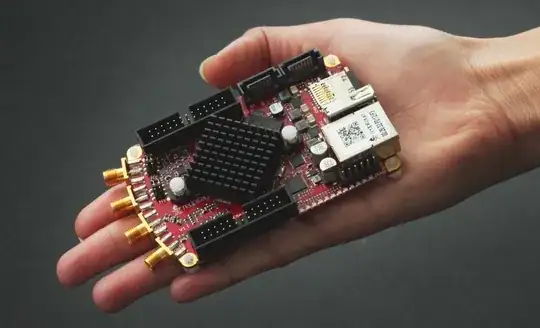

You will be probably better off investing in a Red Pitaya board for running RF experiments like software defined radio.
