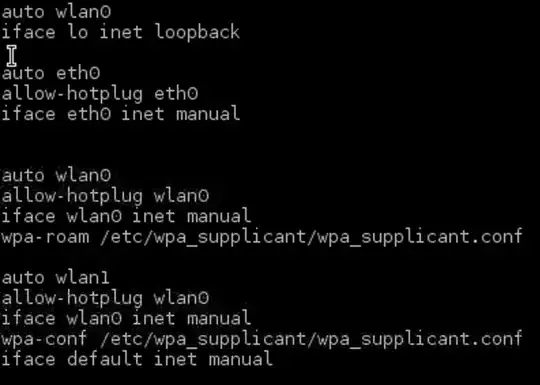

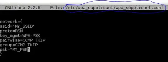

I am using the Official Raspberry Pi adapter for my Pi but I can not scan for networks in the wpa_gui window like I should be able to. Under the tab "Current Status" in the "Status" field, it states that it "could not get status from wpa_supplicant" Here are screenshots of my /etc/network/interfaces file and my /etc/wpa_supplicant/wpa_supplicant.conf files. Network wpa
On the command line as root,try iwlist wlanX scan where X is the index reference obtained from the list under /sys/class/net. If it results in a list of all networks,then your wpa_supplicant.conf may have incorrect syntax.The image is too small to decipher

You appear to have modified /etc/network/interfaces (for whatever reason). Put it back the way it was. The following shows the correct file contents (as well as how to setup).
How do I set up networking/WiFi/static IP address?
