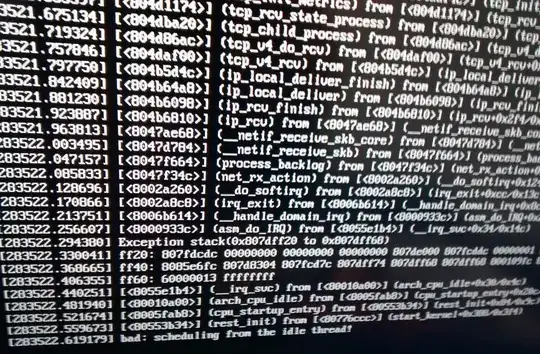

So after some help to locate the problem, I found the problem (I hope). Now I need help to fix it.
My setup:
  • A Raspberry Pi 2 model B
  • Running owncloud.
  • Open to the world. (nginx)
  • Raspbian. Is fully up to date.
  • Has a dedicated power supply which never gave problems with my other Pi's, even tried another power supply.
  • Connected by Lan
  • Has an external hard drive with it's own power supply.
  • Functions quite a bit like a NAS via SFTP.
  • Connected to a TV with a keyboard, for debug purposes.
Sometimes it freezes within hours, this time it was after a few days. This last time I had the HDMI plugged into see a screen full of messages I don't understand. It ends with:
bad: scheduling from idle thread!
And is not responding to anything, ctrl+c nothing works, except pulling the plug and rebooting.
Can anybody help me out?
Bad picture
EDIT
I had an other crash the message here was:
note: nginx[] exited with preempt_count 2
janw
  • 533
This is a not good, as in bad:[, sign; it may have to do with a driver, possibly the driver for the Pi's SMSC ethernet controller, probably something more obscure since it likely isn't something that's affected many people.
Those console messages are from the kernel, and that final one only occurs once in the kernel source, in kernel/sched/idle_task.c (bare with me for a bit if this is beginning to sound like gobbledygook). It's been around for at least a decade (probably closer to two) but there are surprisingly few references to it either in the linux kernel mailing list archive or online generally (and literally only a couple associated with "raspberry").
The "idle task" is one that runs when there's nothing else to do. Tasks, including this one, can be pre-empted so the CPU can be used to do something more urgent; they can also make themselves inactive (aka. idle), so something else can happen -- but not this one, because it's already "the idle task". It can't claim it has nothing to do, because it's what's supposed to happen when everything else has already said that. It should just keep doing nothing until pre-empted.
However, a kernelspace programming error could produce a situation where the idle task does claim it's not busy and should be made inactive. Since that is definitely not supposed to happen, the idle task then reports this error and produces a stack trace, which is a list of references to recently executed code leading up the problem. That's all the stuff before the "bad" message". Stack traces lead into the past, so the last thing there is the earliest thing to happen (nb., the message timestamps on the left have nothing to do with that). At the top of the screen there's some references to the TCP/IP networking module, and further up would be whatever actually triggered the error (which is why I'm guessing the ethernet driver, but that is not necessarily so).
I can't say whether this error in itself should be fatal to the system but it could, and is at least related to the chain of events.
