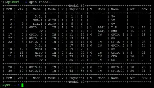

I just got I2C and WiringPi installed a few hours ago. To expand on what @Milliways said, I rebooted and checked the output of gpio readall. See the attached image. It appears most all the pins start as inputs.
gpio readall output on RPi B board
