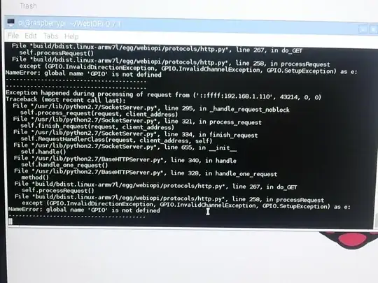

I have Raspberry Pi 2 Model B v1.1 (NOOBS v1.4.2 Raspbian loaded), and I installed WebIOPi 0.7.1 to use it in order to blink a LED on attached to GPIO24 and GND by WebIOPi page.
While I tried to use WebIOPi 192.168.n.n/8000 on my browser, I couldn't change the pins to blink my led. Terminal says briefly:
global name "GPIO" is not defined
But my GPIO is loaded correctly. I have already tried this code to update:
sudo apt-get install rpi.gpio
python3-rpi.gpio
Nothing loaded and nothing changed with me. This is my Terminal's screen:
Exception happened during processing of request from ('::ffff:192.168.1.110', 43952, 0, 0)
  File "/usr/lib/python2.7/SocketServer.py", line 295, in _handle_request_noblock
    self.process_request(request, client_address)
  File "/usr/lib/python2.7/SocketServer.py", line 321, in process_request
    self.finish_request(request, client_address)
  File "/usr/lib/python2.7/SocketServer.py", line 334, in finish_request
    self.RequestHandlerClass(request, client_address, self)
  File "/usr/lib/python2.7/SocketServer.py", line 655, in __init__
    self.handle()
  File "/usr/lib/python2.7/BaseHTTPServer.py", line 340, in handle
    self.handle_one_request()
  File "/usr/lib/python2.7/BaseHTTPServer.py", line 328, in handle_one_request
    method()
  File "build/bdist.linux-armv7l/egg/webiopi/protocols/http.py", line 267, in do_GET
    self.processRequest()
  File "build/bdist.linux-armv7l/egg/webiopi/protocols/http.py", line 258, in processRequest
    except (GPIO.InvalidDirectionException, GPIO.InvalidChannelException, GPIO.SetupException) as e:
NameError: global name 'GPIO' is not defined

From the instructions and screendumps it looks like you are using a Python3 version of RPi.GPIO, but the output of WebIOPi shows it is using Python2.7. Python2 and Python3 are NOT compatible with eachother. You will need to look for a Python2 version of RPi.GPIO such as this one. This package should have been installed by default on Raspbian, but if it didn't or if you messed it up, you can reinstall it by issuing sudo apt-get install python-rpi.gpio.
UPDATE: For Installation patches on an RPI2, please check out this WebIOPi forum thread with a link to a patch that makes WebIOPi work on B+ and 2B.
