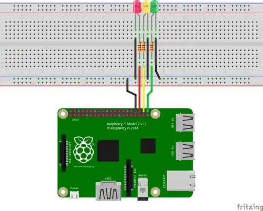

Code, circuit diagram is here - https://github.com/jeffreyantony/multipi/tree/master/Example_01
In my example, there are 3 LED's connected to the GPIO pins of the raspberry Pi. There are totally 4 cores in Raspberry Pi 2. Each core is assigned to blink its corresponding LED.

Circuit diagram enter image description here
