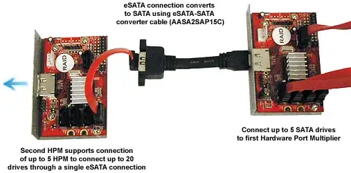

You can build a NAS using...
  1. USB Hub
  2. Sata <> USB
  3. SATA Replicator / SATA Hardware Port Multiplier
    • This is how you can chain the multipliers to RAID, RAID'ed RAID's. You can go 4 multipliers deep and choose from a few raid options. At the Start of the Chain where the blue arrow is your combined terabytes of storage, redundant in the way you configured it to be.
    • This is the standard usage, where you can plug 5 hard drives and RAID them in a certain way, then connect that as a physical drive in 1 SATA port or USB SATA Interface.
You just have to connect the Blue arrow to a SATA to USB converter. As long as you run at USB 2 speeds throughout, you can make quite a mean beefy NAS drive using a Pi.

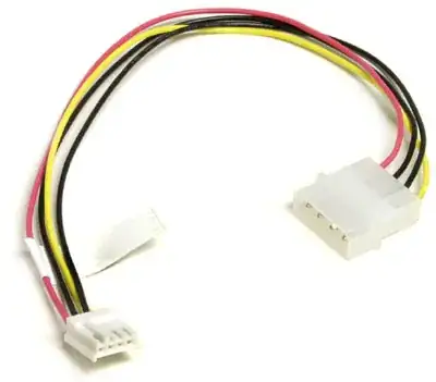

To power the unit there is a standard plug (good old 1.44" Floppy Drive Connector) It is used in all PC's power supplies for accessories now a days. In this picture is a MOLEX converter. It is the smaller connector. The voltages are:
  • YELLOW - 12V
  • RED - 5V
You need to check how many amps it needs. But if you going to power 5X3.5" Hard drives then a 250Watt power supply will be the best option for powering everything, even the Raspberry from the 5V line!
Good luck :)

Specifically useful for Raspberry Pi 2+ and a nice alternative to untrustworthy RAID systems.
Instead of using the RAID function on these boards, configure each drive in JBOD and use ZFS to create volumes. ZFS is very stable and guarantees you won't lose a 'bit' of data before it tells the system it's done. Most RAID controllers, like these possibly, usually tell the system the data is written, then flushes data to the drive, which may become corrupt during flush and then absolutely tells nobody, 'dirty' little secrets.. ZFS, firsts writes, verifies and then says everything is OK. Plus, you can always move your drives into a FreeNAS setup and import the volumes easily as if nothing has happened.
Remember though, the bandwidth is limited to USB2 speeds.
A great speed, and fairly well balanced setup is 4 HDD's setup as 2x2 mirrored. It gives you half the capacity with 1 to 2 redundancy. ie 4 x 1TB gives you 2TB total, but wait... ZFS talks to each drive separately, write speeds of 1 drive (~50mb/s) ... read speed of 2 drives (~100mb)!!!!
A blazing fast combination would be mirror 1 X 4. ie 4 x 1TB gives you 1TB BUT, read speeds of up to 200mb/s!!! Write speeds of 1 drive still.
