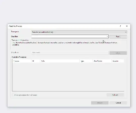

More debugging options
You can also attach to any remote process without opening any project, and just clicking on the Attach play button. But this won't work well if it crashed at launch, but may work if an app crashes at a specific location each time.

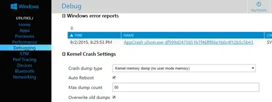

You can view the crash dump from the WebGUI under Debugging but those dump files are Kernel specific and can be very tedious to debug. This doesn't include any error messages, or easy to understand stack dump. More information here, although I could not open any .dmp file in Visual 2015, maybe because its the community edition. But even my Pro 2013 wont open it.
