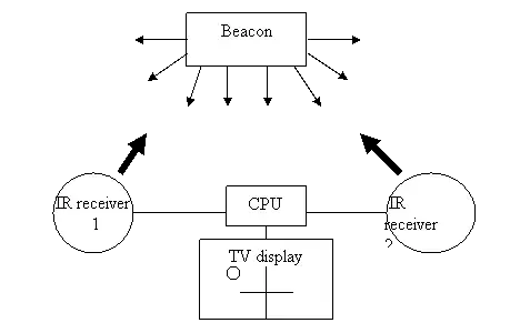

Detecting the location and distance of an IR signal is tricky. To start, you'll need at least two IR receivers. Each IR receiver can detect the strength of the signal, and using the combined information, the CPU can calculate a rough location.
Cornel has a decent write up (source of the image above).
