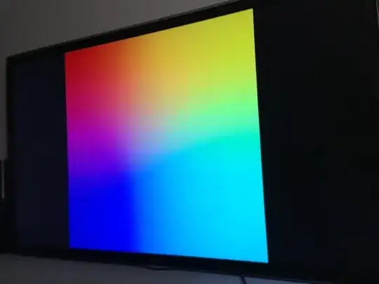

My brand Raspberry Pi B+ works perfectly when I plug in an sd card, HDMI cable, and power. When I plug the EXACT SAME wires + card that work for the pi B+ into my new Pi 2, it freezes at the rainbow screen. By the rainbow screen, I mean this: debug screen from elinux pic
Does this mean it's definitely a hardware problem?

They use different SoC's, the bootloaders are not interchangable. As a test, make a new SD card for the Pi2 from the website download.
Rainbow screen means there is no way to boot, either something with the SD card, or not enough power from the supply.
