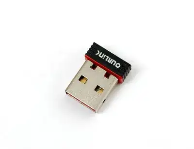

I'm running Raspbmc on my Pi and I use this USB WiFi adapter available from Adafruit.
I had to make the changes shown in this answer to get this interface to come up automatically after a reboot. The driver for this adapter was already in the Raspbmc kernel. It is my understanding that this driver is also in Raspbian Wheezy.
Here's a link to known working USB WiFi adapters for the Raspberry Pi.

I am running Raspbian on my Pi, and I use an 'RTL8192cu' based USB WiFi adapter.
