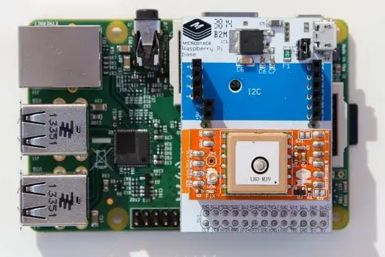

The baseboard you are referring to doesn't just seem to link the GPIOs, it also seems to have a 3V3 voltage regulator, a independent power supply, and likely a lot of resistors and other components on it as well:
picture of baseboard Source

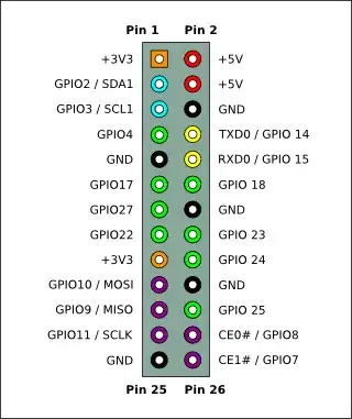

The board connects to the GPIO P1 header on the P1 (the big one in the corner), which has the following Pins:
Source: http://elinux.org/RPi_Low-level_peripherals (Google cached version here if site is still down)
So you could connect the gps unit to the Pi via wiring directly, however without the needed components and a schematic of the board's wiring, this could easily go wrong and fry the gps unit and/or the Pi. Therefore I think it would be easier (and possibly cheaper considering the price and availability of some components needed) to by the baseboard and use that.
N.B. It sounds like the Pi you are using is a original A or B model (you can compare against picture here if you need to), which should work with the baseboard as the site shows it is compatible:
