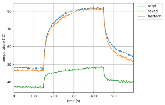

I wrote the little command-line tool stressberry the other day which stresses your Raspberry, measures the core temperature, and produces nice plots. Install with
pip install stressberry --user
and run with
stressberry-run out.dat
