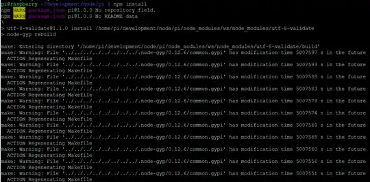

I just run npm install on a project I just got from git, and it starts printing these lines over and over: (it seems like npm dependecies are installed, though, when I ctrl + c)
How can I fix this?
EDIT: Seems like my time is way off. My time is so wrong. It is set to Thu May 7 04:53:33 CEST 2015. The time here is actually 11:15 PM July 15th 2015. I tried changing the ntp servers and restarting the deamon like proposed here: https://raspberrypi.stackexchange.com/a/8054/16299, but it didn't work. Will look for other solution, but any ideas are welcome. I'm not to familiar with this.

Is the clock in your Raspberry Pi correct? It seems to be in the future.
