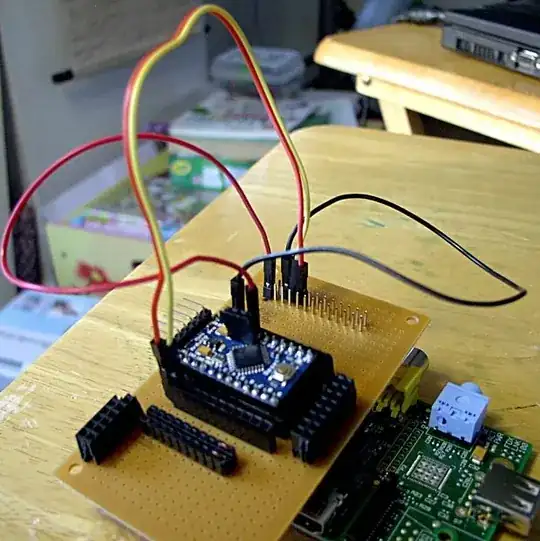

If you use an Arduino Pro Mini designed to run at 3.3V then the requirement for opto-couplers or voltage levellers is reduced. On instructables.com is a plan for connecting an Arduino Mini to a RPi, by making a Hoody. I have made this device and it works great.
Hoody - Arduino Micro to a Pi
Once you have built the Hoody, then with the addition of a FTDI to USB interface and the libraries you should be good to go.

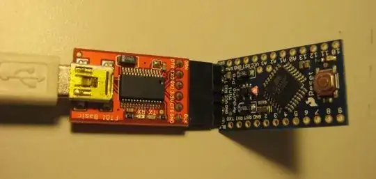

The Arduino Pro Mini connected to (and powered by) a SparkFun FTDI Basic Breakout Board and USB Mini-B cable. Note that on earlier Pro Mini boards the orientation of the 6-pin header may be reversed; check that the words GRN and BLK align on the Pro Mini and FTDI Basic Breakout.

Be careful to note, get a 3.3V Pro Mini, and NOT the 5V, otherwise voltage level shifting and opto-couplers will be required.
ADDENDUM: I am not 100% sure that the Keyboard/Mouse libraries will work with a Pro Mini (as they require 32u4 devices), however, it would be easy enough to write a sketch that fires the appropriate signals to the FTDI.
