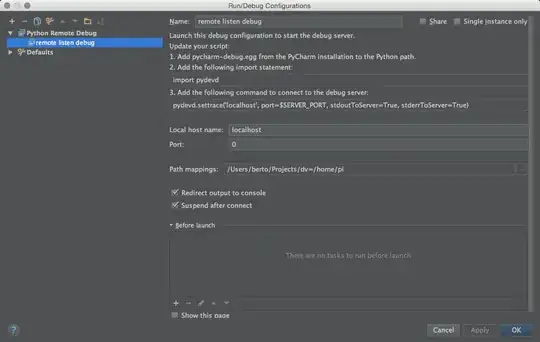

In PyCharm, go to Run -> Edit Configurations...
Hit the + sign on the top left and select Python Remote Debug. Simply give it a name, remote debug and you're done here; hit ok.
remote debug configuration

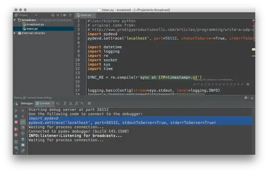

Now click on Run -> Debug 'remote debug' and you'll see a message in the debug console, Use the following code to connect to the debugger
Copy the lines, in my case they ended up looking like this:
import pydevd
pydevd.settrace('localhost', port=56112, stdoutToServer=True, stderrToServer=True)
Paste them at the top of the file you're debugging and save the file.

PyCharm should show you a message Waiting for process connection...
waiting for process connection
On the RPi, run the program and you'll see the debugger kick in. By default it pauses on the line right after the pydevd line, which you can change in the config if you wish.
And at that point you're remotely debugging! :)
