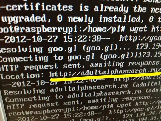

Having analyzed, tried, and experienced three links (credit to @Steve) that are constanly being updated here is the answer that works for me as of momemt of writing:
rm -rf /boot/*.elf /boot/*.bin /boot/*.img
apt-get install git
apt-get install ca-certificates
wget http://goo.gl/1BOfJ -O /usr/bin/rpi-update && sudo chmod +x /usr/bin/rpi-update
/usr/bin/rpi-update
Do not mistype 0 with O, in the snippet above both are capital O for October.
Do not mistype
To see if the new memory is allocated type free in the console to see free (available) memory.
