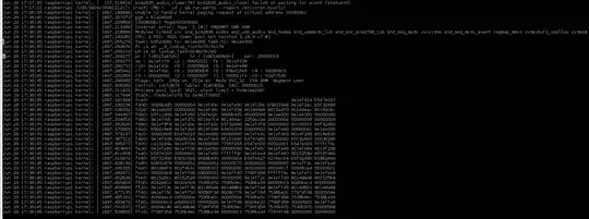

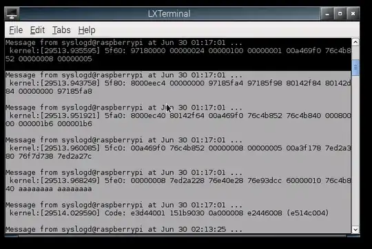

I notice that when the system is left for long periods with no activity, this can cause everything to stop working, and terminal throws up all kinds of message from syslogd@raspberrypi messages that I don't know the meaning of.
This is on a Pi2 running Raspbian (relatively new version)
I will dump some of the errors here, and I hope someone can help explain why these errors occur, and what can be done to solve them.
The result from uname -r for me is Linux raspberrypi 3.18.9-v7 #1 SMP PREEMPT Fri Mar 20 11:10:23 UTC 2015 armv7l GNU/Linux In case that information is useful (as this is a kernel issue it would seem)
One message that stands out as a little different is something like: "Oops error 17 SMP PREEMPT ARM" which may tie in with the above result from uname -a
(Apologies it will have to be a screenshot as the froze up when I tried to copy/paste the messages)

That's literally just the tip of an iceberg. By "literally", I mean system log messages are classified into 8 levels of priority (see man logger or man 3 syslog), and, depending on configuration (see /etc/rsyslog.conf; it might also just be syslog.conf), the highest one or two of those will be set to broadcast to all terminals.1 This usually indicates there will be lower priority messages leading up to this. Where the lower priority messages will be also depends on configuration, but on Raspbian by default a copy of every message goes into /var/log/syslog.
So you should be able to read back through /var/log/syslog -- or where ever the equivalent is on your system -- and find those high priority messages intermingled with others. They should have more human decipherable timestamps such as Jun 30 07:31:34; the kernel ones in your terminal output are seconds since boot and they will be there too, which makes it easy to search for them (the string 29514.029590 probably doesn't appear more than once).
1. I think the kernel may also do this even on a system with no logger, which is why having a logger is a good idea.

What's in your log turns out to be pretty unfortunate, because it involves a "kernel paging request" error. This can have two causes:
1) Bad memory. Which you can't replace on the pi. You can confirm this by testing it; a common way to do that is with Memtest86, which is what the screenshot in that link is from. That isn't available for the pi, but apparently there is a memtester in Raspbian/Debian; some discussion of that here and here. They are fairly simple to use but take a while.
2) Otherwise, it's a kernel bug. This is kind of worse, because you can't fix it for $35. In fact, you probably can't fix it at all; just diagnosing it will take a certain level of technical expertise (if you think you are up to it you could start here, but do not be afraid to admit you are not; surgeons do not become surgeons over the course of a weekend, or even a month or a year).
