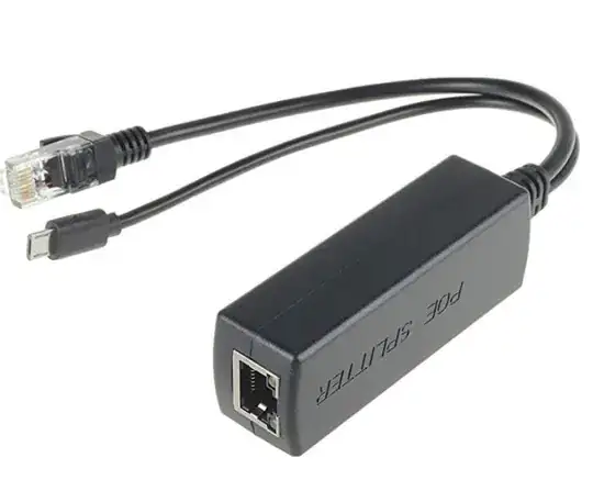

POE Hat or POE Splitter: Since the POE Hat comes with a fan- which I hear come on quite frequently when used with my POE Pi-Cams- this probably wouldn't be suitable for this use-case. So I'll talk about the Splitter used to provide POE capabilities to your Pi only.
£9.90 currently from amazon.co.uk found here. It works by splitting the data from the power and diverting the Power from the POE Ethernet cable to the MicroUSB cable sticking out of the splitter which you connect to the Pi's power port. The Ethernet cable on the splitter of course connects to the Pi's Ethernet port. No tools requires and no instructions required for configuration.
POE SPlitter

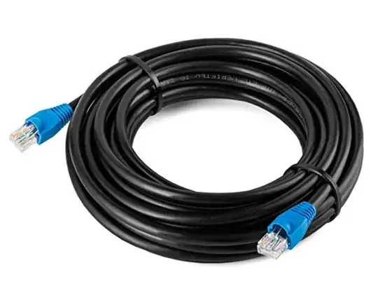

Outdoor Ethernet Cable: Now you require an Ethernet cable to connect to your POE Splitter connected to the Pi in the birdbox to the POE Switch in your house (which I'll cover next). You CANNOT use a standard Ethernet cable- the weather will hammer it. You need one designed for use outdoors. The 20 meter cable (shown below) I use to power a wireless AP in my backyard for Internet surfing from my hammock can be bought here from amazon.co.uk for £11.39. Note that this model is sold in different lengths. It's 24AWG, so has thicker copper medium making it more suitable for POE purposes. And it's even Cat6 better still. Outdoor Ethernet Cable
