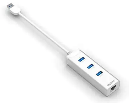

I'm trying to use one of these to boost my networking speed on a Raspberry Pi 2 Model B.
Arch Linux ARM correctly detects the USB hub, but fails to detect the Ethernet port. ifconfig does not show any new interfaces (It should show eth1).
This adapter works on Raspbian!
How can I get it working on Arch Linux?

From man ifconfig:
NOTE
This program is obsolete! For replacement check ip addr and ip link.
Although that's not the problem here (it still works fine), I thought I'd point that out. The issue is:
If no arguments are given, ifconfig displays the status of the currently active interfaces [...] if a single -a argument is given, it displays the status of all interfaces, even those that are down.
Unless the system is configured to do otherwise, a newly attached interface is down. To change that:
ip link set eth0 up
Or the obsoleted ifconfig eth0 up.
why doesn't it show normally, like it does in Raspbian?
Again, that has to do with your network configuration.
goldilocks
  • 60,325
  • 117
  • 234
Apparently, the solution is to make a new network config file in /etc/systemd/network containing:
[Match]
Name=eth1
[Network]
DHCP=both
This will make netctl go and fetch an IP.
