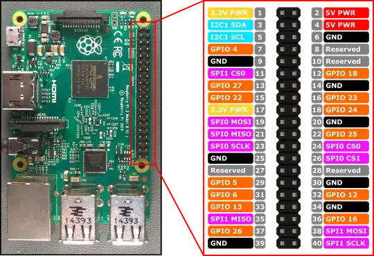

I then looked further at GPIO17 (physical pin 11) and found that according to https://ms-iot.github.io/content/en-US/win10/samples/PinMappingsRPi2.htm, Microsoft says physical pin 11 is SPI1 CS0.
https://ms-iot.github.io/content/images/PinMappings/RP2_Pinout.png
Is there any way to reclaim physical pin 11 as GPIO17 in Windows 10 IoT, or are we just stuck with it being permanently configured for SPI1 CS0?

It appears that Microsoft have now added Pin Muxing support. As pointed out by David C - my link above has been updated with the following:
"Some GPIO pins can perform multiple functions. By default, pins are configured as GPIO inputs. When you open an alternate function by calling I2cDevice.FromIdAsync() or SpiDevice.FromIdAsync() , the pins required by the function are automatically switched (“muxed”) to the correct function. When the device is closed by calling I2cDevice.Dispose() or SpiDevice.Dispose(), the pins revert back to their default function."
I also note that they now list GPIO17 (pin 11) as defaulting to GPIO now, so it looks like my original issue has now been fixed.
