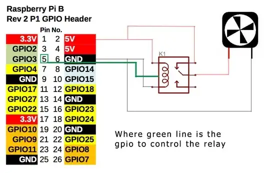

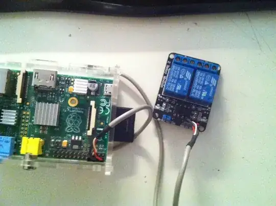

I have a Raspberry pi Model B revision 2 and I've set up a mini 5v fan on a relay switch which i want to control with python now. I will be running a crontab every hour to check the temperature of the pi and if the temperature is above 50C i will be running the fan for like 10 min. This is my current setup:
The relay is connected like this diagram here:
I've setup the relay this way, because it has a light on top of it (a red light) which i want it to be on when the fan is working...and off when its not.

Now the problem is that i am getting some warnings which i just cant get rid off:
root@raspberrypi:/home/pi# python fan.py
fan.py:14: RuntimeWarning: This channel is already in use, continuing anyway.  Use GPIO.setwarnings(False) to disable warnings.
  GPIO.setup(FAN_PIN, GPIO.OUT)
fan.py:14: RuntimeWarning: A physical pull up resistor is fitted on this channel!
fan off
Finish
The line in question as you can see is this:
Why am I getting this error ? i have GPIO.setwarnings(False) in my code. And also should i be using that pin for controlling the relay ? Is there optional pin i should be using ? Thanks.

In addition to moving off the I2C pin, you'll want to un-comment (remove #) the last line so your GPIO will cleanup. This will reset the GPIO and remove your warnings and errors the next time your script runs.
