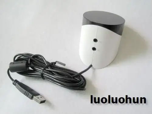

I want to receive and generate IR signals with my PI. What is the best way to reliably do this? Would it be with something like this?
