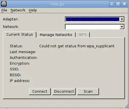

Through the GUI, it doesn't find an adapter and the status is as follows: enter image description here
