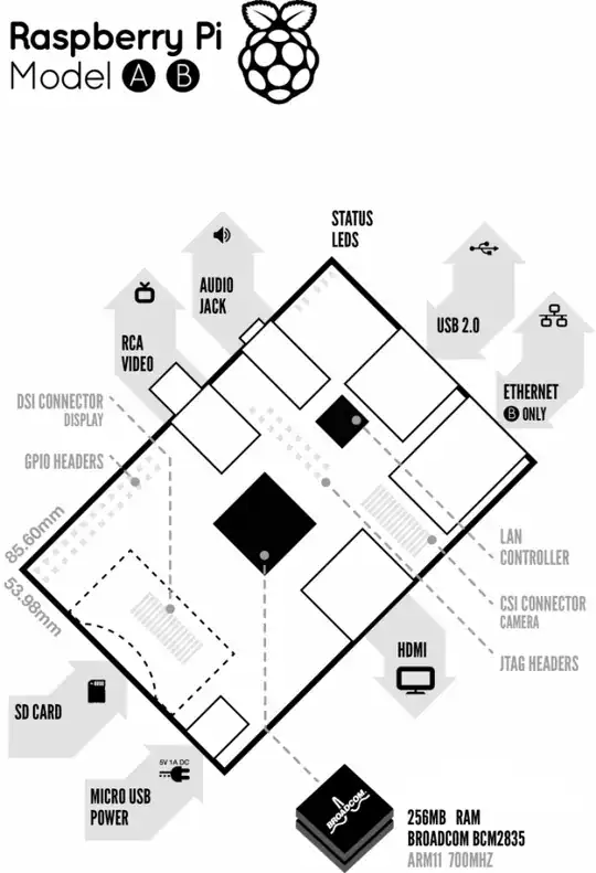

It's not really inside the SOC, as it is a separate component, but on A/B/+ models is stacked on top of the SoC, which is why the processor isn't labelled "Broadcom" (instead, probably "Samsung", who make a lot of low power mobile memory). Apparently on the Pi 2 this isn't the case -- the RAM is on the bottom of the board.
Elinux has a diagram of this which has no specific license so hopefully I'm okay linking it here. This refers to an A/B and only indicates 256 MB, but the + is the same in that regard:
