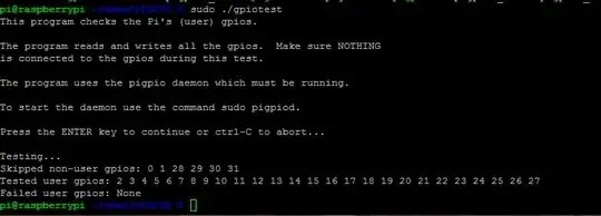

I tried testing GPIO4 with an LED and Python.. but I cannot seem to get it to switch state to .HIGH (Possibly Faulty GPIO pin?)/(Locked by Kernel?)

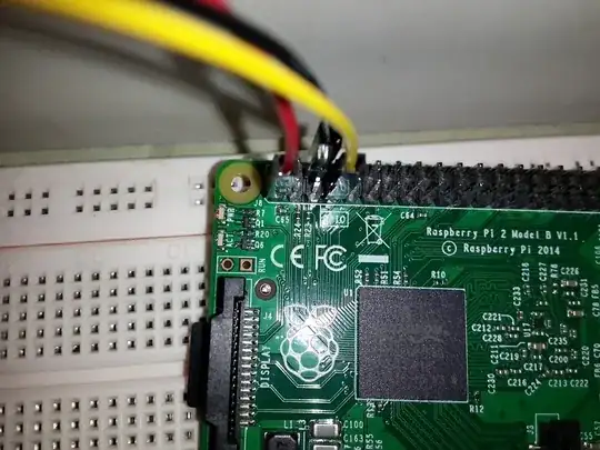

  1. Connection to Raspberry Pi GPIOs
    Pin Connections on Raspberry Pi

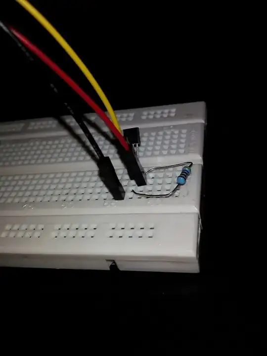

  2. Breadboard Connections and layout
Bread board layout

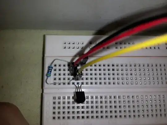

  1. Different Angle as to see the Resistors Placement
Different Angle on breadboard
  1. gpiotest Results enter image description here
