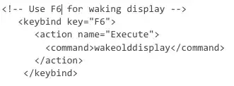

Then add a keybinding In the keybindings section of /home/pi/.config/openbox/lxde-pi-rc.xml enter image description here
Now when the screen's asleep, and won't wake up, I just press F6, and the GUI screen comes up, ready for use.
