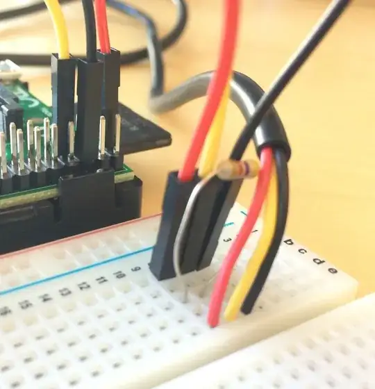

Trying to install DS18b20 temperature sensor but it looks like the RPi cannot find it.
From console:
sudo modprobe w1-gpio
sudo modprobe w1-therm
cd /sys/bus/w1/devices/
ls
But there is nothing there :(
Have I done the wiring correct
Nicole Svensson
  • 111
Nr 3 did the work. Thx for quick help. sudo nano /boot/config.txt dtoverlay=w1-gpio,gpiopin=4
